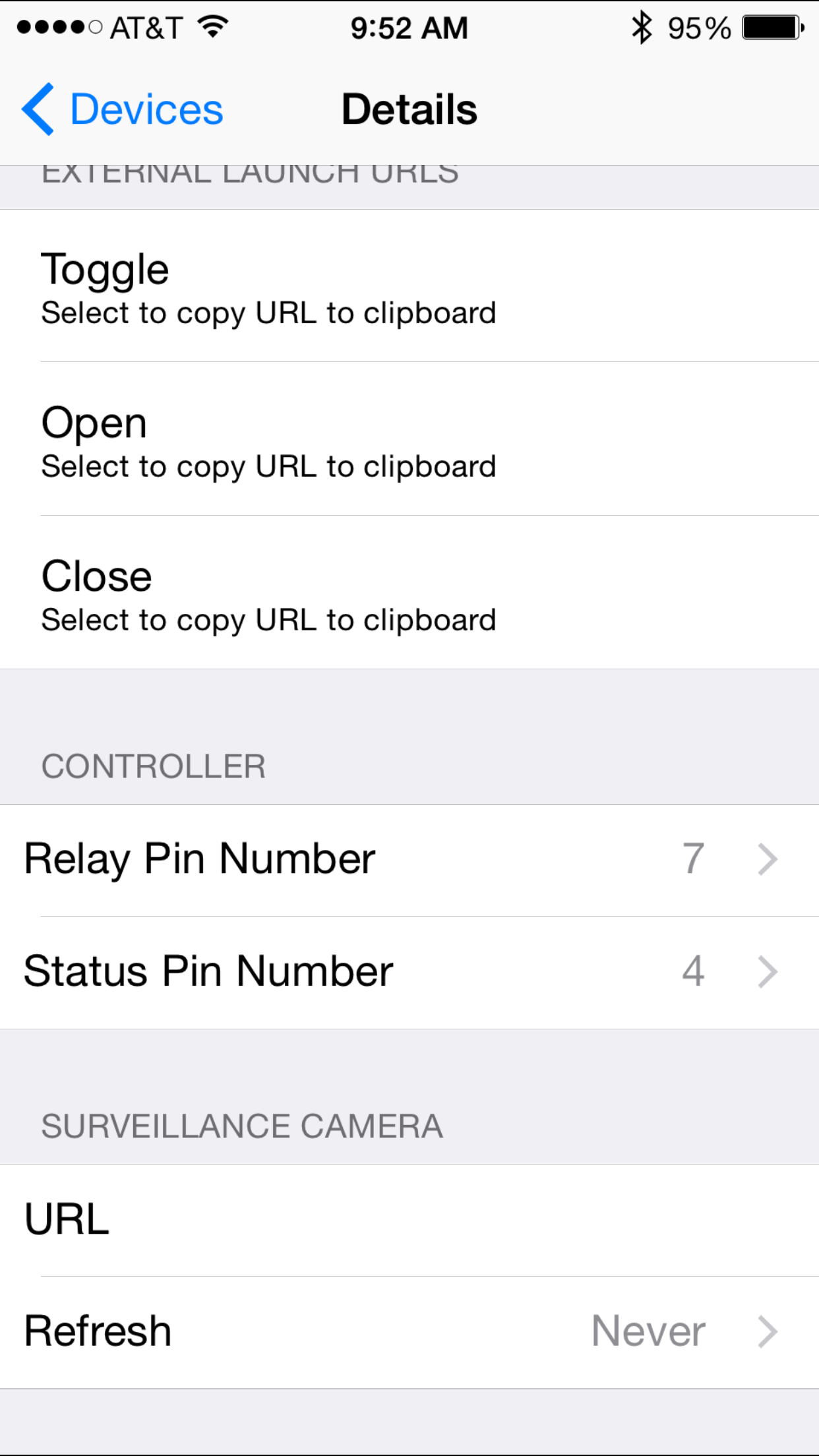

I have setup the iphone app and it appears to be working when you press the button to open the garage, but nothing happens on the garage door and the relay doesnt make a sound either.
Here is a copy of the .ino file, maybe someone can see if they notice something wrong with it?

The first thing that comes to mind is: have you configured the relay pins on the iPhone app for that device/door to match the one in your .INO file?
Re: Relay not clicking when opening on app
Postby colby82 » Sat Oct 03, 2015 9:54 am
Thanks for the response! Yes I have selected the correct pins in the iOS appbased on what I have setup in the .ino file .
When I press the open button on the app I can see the led's light up, but I just can hear the relay make a noise. I would like to confirm I didn't damage the board, is there a way to get a copy of the sketch that comes preloaded on the xboard that makes the relays fire repeatedly to show they are working? That what I can tell of its the board of the sketch, I think?
Thanks
Colby

I just tried loading some sample code and I can get the relay to fire using it, so im really not sure what the issue is. Here is a screen shot of the iOs app to show the correct relay pins are selected.
iOs app screen shot
