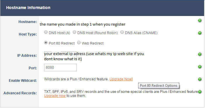

1st go to http://www.whatismyip.com/
2d go sign in for a no ip adress or any other (http://www.noip.com/)
3d go in host/redirect tab, add host tab , chose a host name (any name is fine),chose port 8080, your external ip, and add host

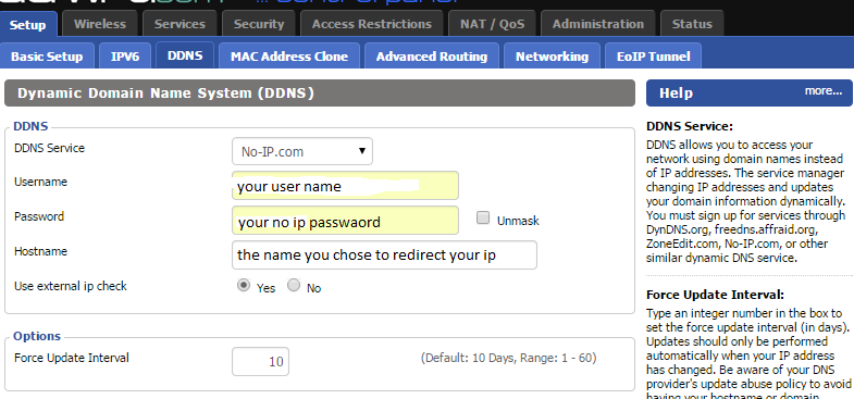

4th go in your router config and do the ddns config like i did, our exyeternal ip change time to time my router have the option to make change by itself on no ip website, so i dont have to do it manualy

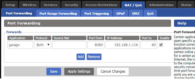

5th go in port forwarding and fill up name of application , source leave blank , port i chose 8080 to redirect to 80 incase my isp block it, ip adress well the ip of your module and port of the module.
