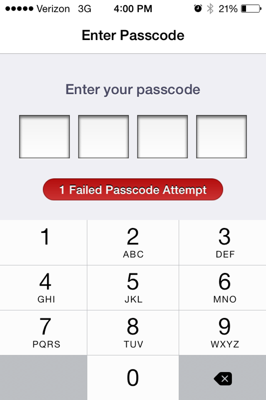

Ok, after being using my DoorOpener for over a year , i even switched phones and no issues , this weekend went to use the App to close the door and asked me for a Passcode, well for the Love of God i tried every code i can remember but nothing , deleted the App but nothing goes back to the same old please enter passcode , i even tried doing a restore from my backup but same please enter passcode.
now the question is how can we wipe out the app and start a fresh install so it allows you to start a new setup and not looking at the old informtion

so, at this time i am kind stuck on this , i never entered a Passcode to this APP , it must been done on its own while having the phone in the pocket unlocked.
so seems like the APP is keeping the Security settings saved somewhere , by deleting teh App and reinstalling it does not work , looks like the only way to fix this is to do a phone Restore to a previous ver prior the App applied the Passcode settings

Passwords are store on the device's keychain which lives across multiple application re-installs. This is a security feature of the iOS operating system and is by-design from Apple. There isn't much we can do about it ... The only thing I can think of (not sure that's even possible), would be to use a 3rd-party application that would allow to connect to your device using USB (from a computer) and would allow you to "tweak" your device's keychain to have the MyDoorOpener keychain entry removed.

Well, i was not able to clean up the security history of the App, so the only way for me to get it back was to restore my phone to an earlier backup prior this thing changing the settings on me.

Again, this is an iOS keychain issue. That's where we store the password (as per Apple security guidelines). It's a security feature,
but I agree that in those cases where you forget your password, it can get pretty nasty. At least, now you're back in a working state.
