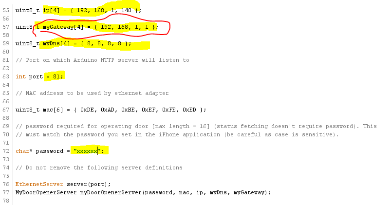

Postby TVTuga » Wed Sep 23, 2015 8:34 pm
John,
did you enter the Router IP Address as the Gateway , attached is the screen shot of my set up

Re: Prowl notifications not sending
Postby johnt365 » Wed Sep 23, 2015 10:03 pm
Thank you very much for the clarification. I have a minor networking question now. Here is how my network settings look now.
My local IP is the same as you set for your gateway. However, my gateway and Local DNS are just 0.0.0.0
How do you know what to put there or can I leave it as 0.0.0.0?
I tried to set the gateway and local Ip as the same number but that did not send the notifications.
Thank you again on this the screen shot was a big help
John

Postby TVTuga » Thu Sep 24, 2015 8:50 pm
Hi John
The Gateway is the Router IP Address , and the IP Address is the IP that you want to give it to the MyDoorOpener
Regards
